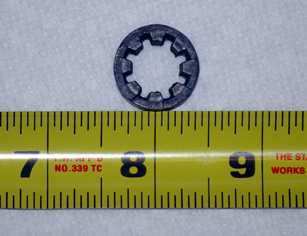

OK - here's the scoop after I had time to dig into it...
The only problem is the rubber coupling which has dried out and cracked. Picture is attached. Anyone have a clue where to get one of these?
Dlattan
