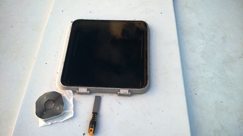

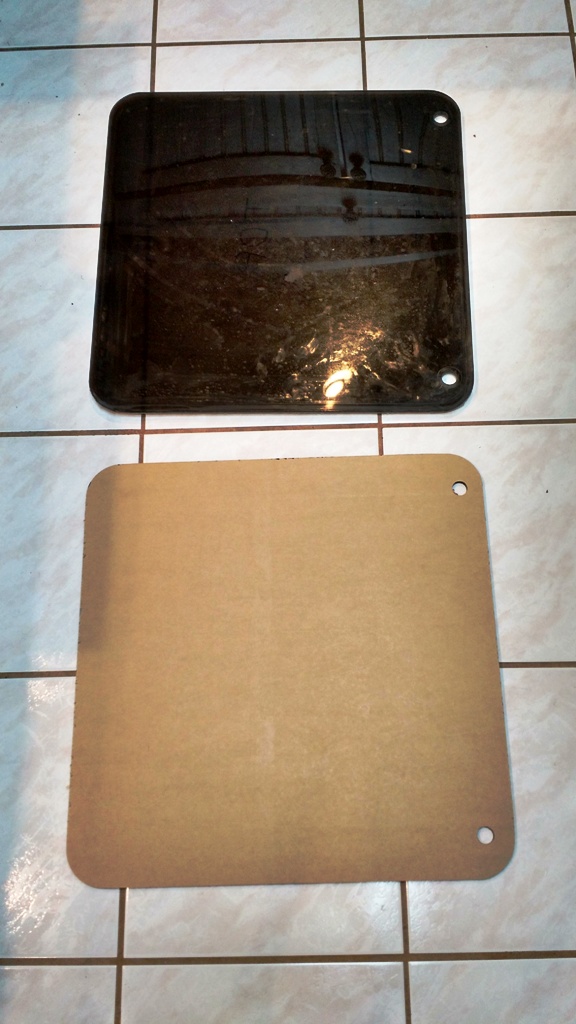

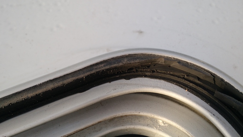

I was shocked that the hatch lens didn't break when I pulled it. I used contact paper hold the lens together when I pulled it. I also used contact paper to cover the hole against bugs and rain while I had the replacement made.
