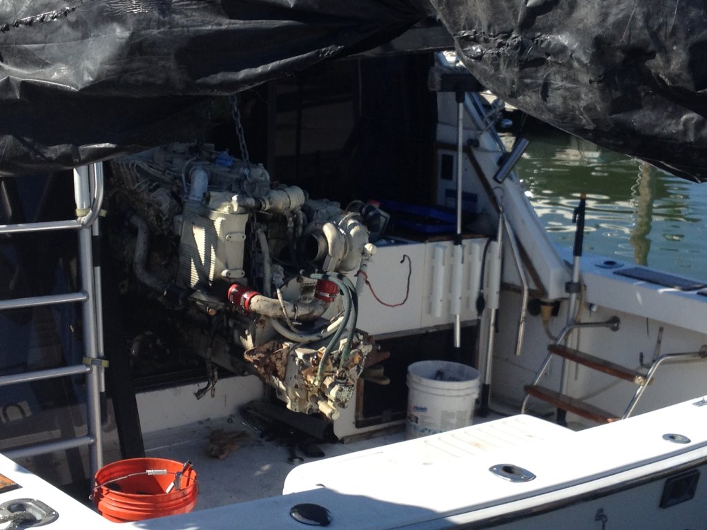

zedtwentyate
Posts: 335
Re: Planning My Haul Out and Motor Pull
Post by zedtwentyate »
Well, they are out and nestled cozy in my garage, just waiting for me to pay them a little attention.
Special note to anyone hauling with a crane...pull them in front of the radar arch. We tried behind first and that was a fail. In front was perfect and easy.
P.S. - My bilge is almost as dirty as my garage! Don't judge me...
Here's some pics for your viewing pleasure...

Re: Planning My Haul Out and Motor Pull (Update: Motors are out with Pics)
Thanks for the update , the fun has just begun ,
