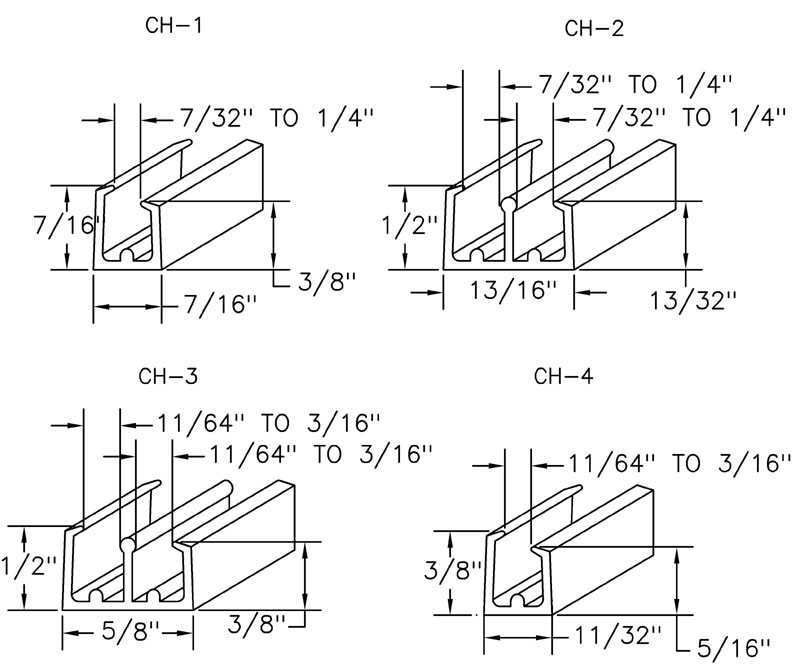

I assume you found the link purchase the h-channel from Beacon, at https://www.trojanboats.net/zencart/ind ... cts_id=199
Not sure what kind of pics you are looking for .. I have H channel at top and bottom of each slider, forward edge of forward slider and aft edge of aft slider, of each pair of windows (4 pairs), if that helps...

I order new window channels for my 1970 36 Tri.
http://www.beckson.com/channel.html
