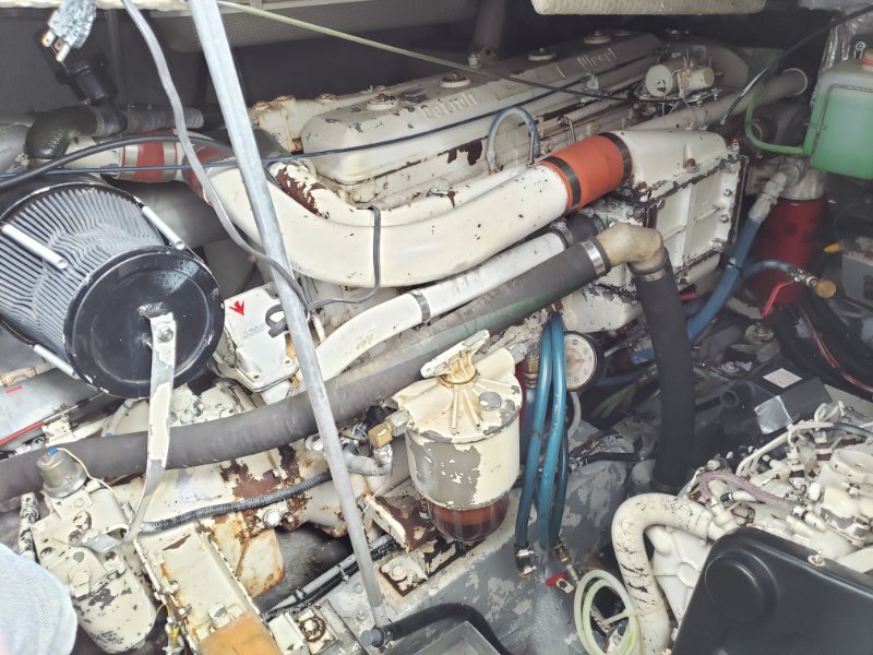

Just a few more pics I took yesterday

Red Flag !! Your coolant is wrong for the Detroit's You need a coolant that meets Detroit specs with the right SCAs .Without it cavation can cause cylinder sleeve damage . flush it and get the right stuff in it . Not sure if your gen set is sleeved but it would not hurt to do the same too it .
I have to ask what oil is being used in it ?

Thanks for the concern. Not sure if I need to be but I will check into it. It was/is still winterized and out of the water, will be flushing it before it goes back in. I will definitely ask about the oil. Thx!

First of all, I have to say that I am far from an expert on Detroit Diesels.prowlersfish wrote: ↑Sun Mar 17, 2019 8:43 am Red Flag !! Your coolant is wrong for the Detroit's You need a coolant that meets Detroit specs with the right SCAs .Without it cavation can cause cylinder sleeve damage . flush it and get the right stuff in it . Not sure if your gen set is sleeved but it would not hurt to do the same too it .
I do have an early Ford Powerstroke 7.3L that requires SCA in the coolant and I have done research on keeping this engine safe from cavitation damage to the cylinders. I run a yellow (looks yellow/green to me) coolant that is OAT based and also add a SCA additive that is blue. My coolant mixture looks similar to the coolant that ReelWild has in his engines. You can purchase test strips to determine your SCA level and I test every six months to see if I need to add any.
Without testing, you cannot be sure there is no SCA in his coolant. That said, the coolant in the photo is probably not on the DD list of approved coolants.
Re: 1987 13 Meter Express Hardtop - Newly Acquired
Probably be ok using a green coolant with a SCA . I just like using a OEM spec coolant in a sleeved engine . Cheap insurance
