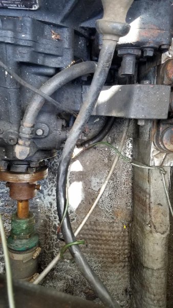

I am trying to find out any info I can about the 215 transmission. I have a 1972 Trojan with 351 ford engines and these transmissions. I don't know if they are straight mechanical drive or hydraulic? I don't know what oil they take if any or will I be putting oil on a clutch and they take no oil ? I do know that one of them is very poor going into gear slow going in to reverse and sometimes not at all ? Any help would be greatly appreciated. Thanks Steve

You would have a BW velvet drive or a paragon trans Bothe use ATF , I prefer dexron post a photo I could tell you what gear you have . And Both are hydraulic .

This is best I have now will post a better pic if needed? Thanks for info
Posts: 12732
Re: 215 MerCruiser Drive / transmission
BW Velvet drive
