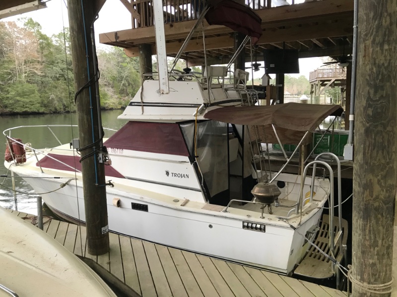

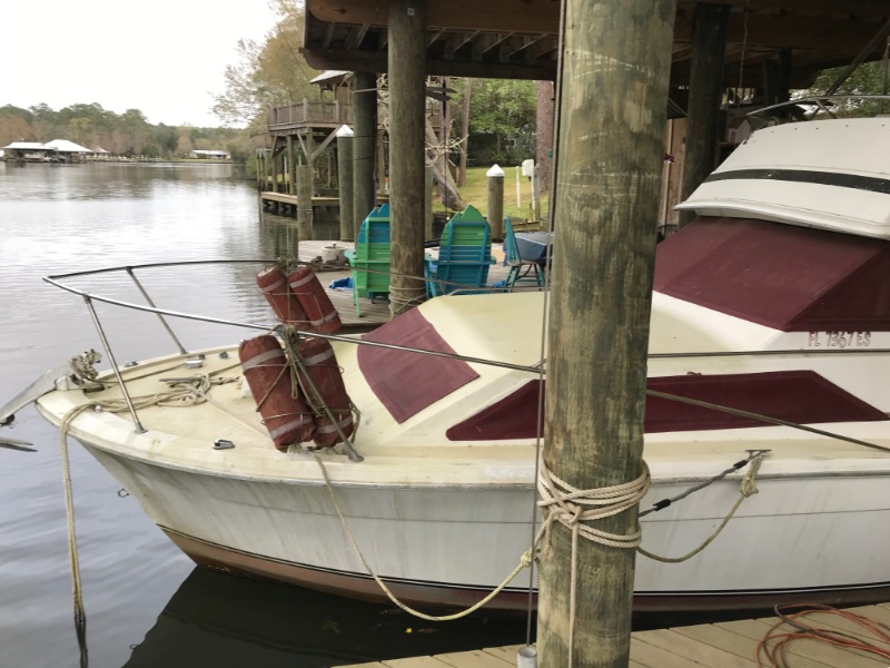

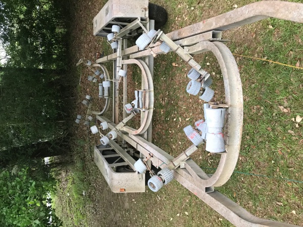

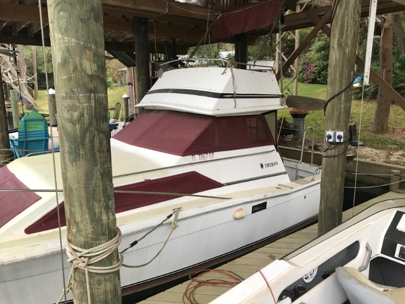

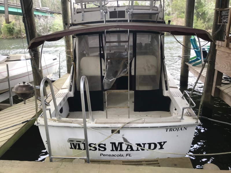

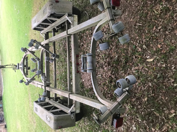

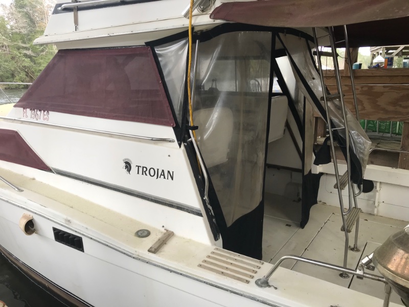

Here’s a few shots of the boat. She is very dirty, but she is structurally sound. Had not been ran in about a year when I got it. A quick battery charge, and the little yanmar fired right up. Shut her down after 3 min of a nice idle, with the intention of not cranking her again until All fluids and filters are changed and impellers are replaced. A clean fuel cell with fresh diesle is in order too. I included a photo of the trailer to get some opinions from you men. Most of the wobble rollers need replacing, as well as all keel rollers. Gonna get expensive pretty quick. If any of you folks can supply dimensions and bunk layout of a trailer with runners for this boat, I think I’m gonna go that rout. I welcome any and all opinions and advice from you guys.

Other than the DOCK LADDER on the transom, this boat has a great deal of great possibilities, as long as you realize it's limitations regarding wind, current and seas.
Don't think she's a candidate for haulover inlet
If you don't know what that is, just go to YOUTUBE and type in those two words
Otherwise she can be a really sweet, economical boat for some PURPOSEFUL fun.
Keep us posted on your progress

Great looking boat , It should clean up nice . Looks like someone put a lot into this boat at one time . Can't help you much on the trailer as I have seen very few on a trailer .
