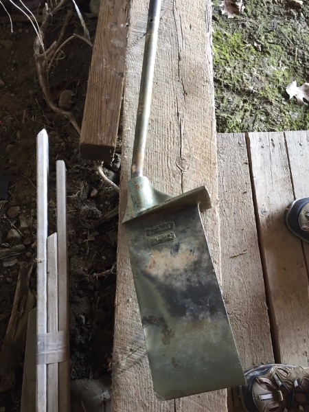

Lost steering today. Got back using reverse (prop walk to port) and bumping forwards and reverse. Not pretty but it worked. Any ideas why it fell off?

I would guess it was damaged at one time and repaired, maybe the shaft was replaced.
Beacon may have a rudder.

Yes, the shaft was straighted and work also done on the prop after I found “that rock” after 44 years on the same lake. Picture is from when the rudder and stock were removed before repairs. I think the rudder came off at the coupling and now is “somewhere” on the bottom of the lake. FUN! I’ll reach out to Beacon. I’ll probably just let it be a “camp” for now and get started on replacement when the boat’s on the hard this fall.
