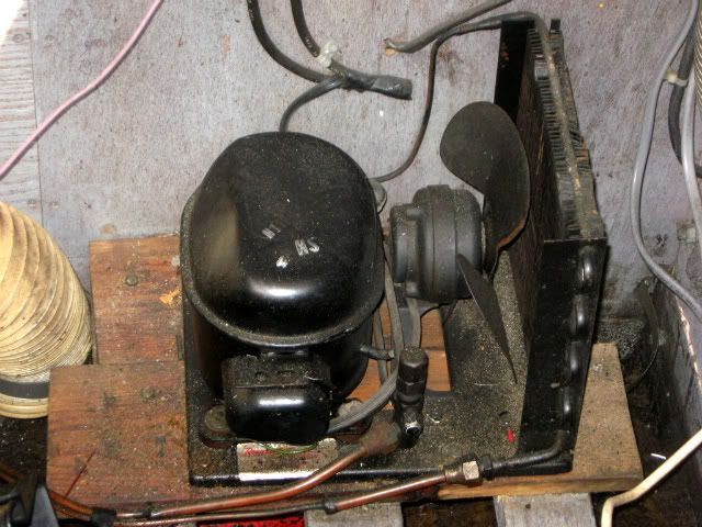

i went and looked at possibly my new f32 today and while i was crawling around in the bilge i came across this. it looks like its for the fridge but i don't know for sure. its mounted right behind the front bulkhead. it's a 1975 f32. needs some tlc thats for sure, alot more then my f30 needs!

Looks like a condenser for a refridgerator. With the fan for cooling the motor. Good luck.

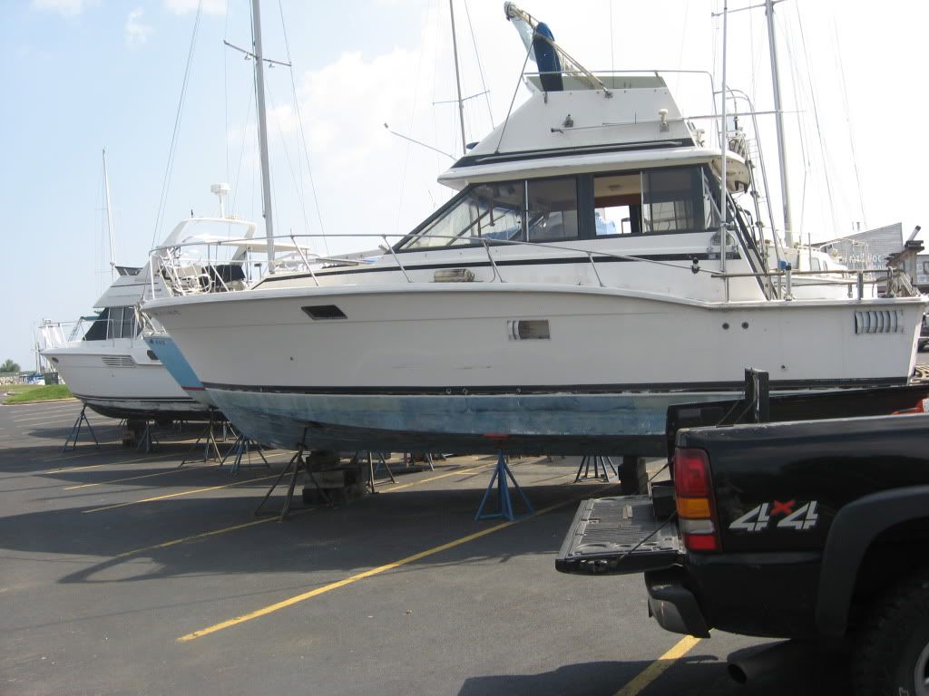

thats what i thought but i wasn't sure. does anybody know if i can get the side louvers anywhere? also 3 side windows are broke, 2 front and one middle. can i get glass for these or do i have to get it cut to match? someone told me the broken glass was pretty common in the f32. coast guard won't give me a clean inspection until they are fixed.

Try Beacon Marine for the louvers.. https://www.trojanboats.net/zencart/
Glass will have to be cut to fit.. your local auto glass co. should be able to supply them.

I made several new louvers out of aluminum sheet that I got at a recycle yard. Get a metal cutoff blade for a radial arm or table saw and cut them out. Then using a vise bend to fit and pop rivet them into the frame.
