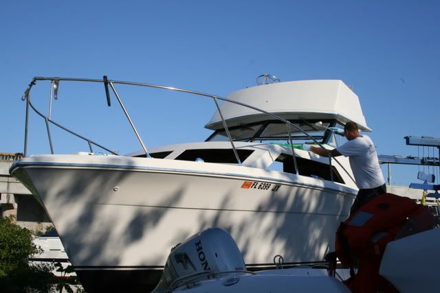

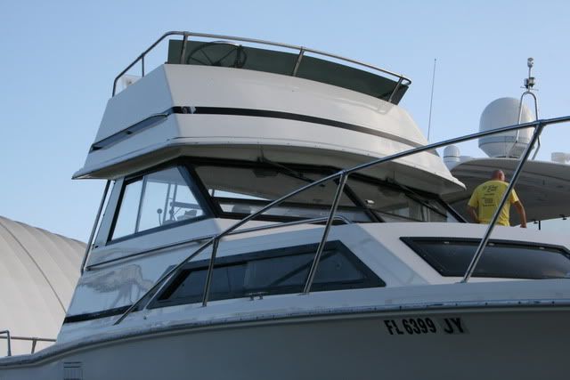

Let me clear this up. The 32 was painted by a pro (spray) and involved a total tear down, 24K keel to bridge. The job was great and the boat looks new but it was a lot of money for a "old boat" and I didn't want to spend that kind of money on the 26. As I said in my post "With all the prep work done the painter charged me $600" This was just for the guy to come in and paint, He didn't sand, tape, wipe down, or anything. He came in and painted. The only thing he touched was a brush. I did all the work to get it to the paint stage. He came in for 4-5 hours on 3 saturdays to do the 3 coats and I sanded during the week. His rate was 40 per hour and I think that is a good rate for a boat painter to get on his off time. This was just a guy, not a company, and I of course had other charges like the haul out, paint, sanding and prep supplies. I can't paint like this this guy did and the outcome was well worth the 600.00. One more thing, there are more layed off boat painters here in Lauderdale than taxis in NY so that might have helped on the price. There were no shortcuts taken on this project I just did 90 percent of the work myself, the painter guided me, and I think Foofer wanted to do most of the work himself. But word of warning, I did save a ton of money but it was a lot of work for both me and my wife and I am not sure I would do it again.
I took the windows out, wind screen, and the grab rails-
After the paint I added trim tape
