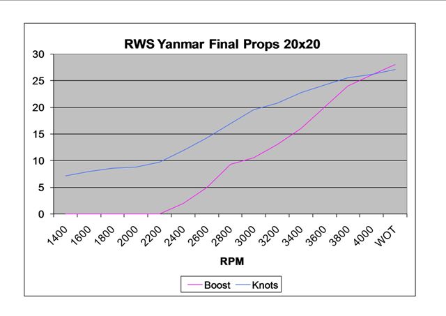

I can't comment on the smaller diesels, but here is the performance chart for my 6 cylinders (if I can figure out how to post it correctly)

I notice you numbers are close to the same 170 hp ( speed vs rpm) I thats why I don't believe there Numbers , I also ran them on Boatdiesels calc. before there a pipe dream .
- RWS Yanmar Chart 2.jpg (32.65 KiB) Viewed 4147 times

That's what I thought. I agree with you that it seems that it would be underpowered. If it were mine I would have gone with the same engines as RWS. I wonder where that boat is now? Thanks for the other article, looks like they did a nice job. I always liked the 10 meter and think it's worthy of a gas to diesel repower.
RWS,
Thanks for sharing your numbers
Matt
