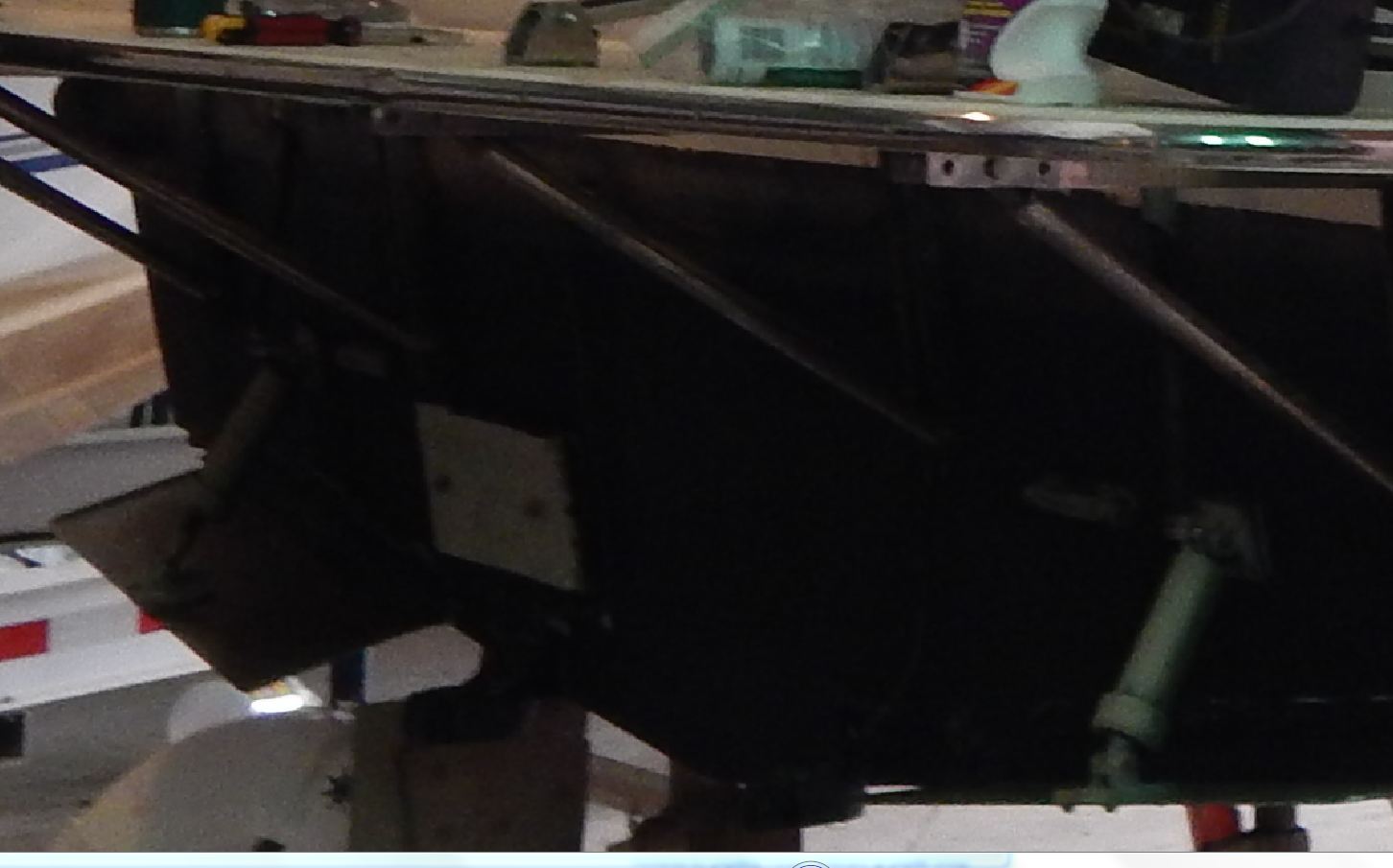

I removed the swim platform mounts on my transom and re-purposed the holes to install underwater lighting. just off-center to port there is a metal plate mounted to the transom below the water line. it is about 16" x 8" or so. It looks like it's been there since the boat was built because there was no bottom paint behind it.
I removed it to have access to install the light, and also prep the area since I am refreshing the bottom paint. I am curious if it is a zinc plate (its non ferrous), but it just "feels" more like aluminum. There is a green wire attached to the studs on the inside, so I am wondering if this is sacrificial metal, or would this be some sort of grounding plate? I am on Lake Michigan, so I really don't need zinc, so I want to know if this can be eliminated.

Could be a ground plate used back in the Pre Vhf days ( am 2 way raido ) also aluminum is used instead of zinc in fresh/brakish water some times ( don't mix )
Update ; The aluminum is used is salt as a replacement for zinc and recommend for brackish water . It is also list for fresh but I believe magnesium would work much better .

prowlersfish wrote:Could be a ground plate used back in the Pre Vhf days ( am 2 way raido ) also aluminum is used instead of zinc in fresh/brakish water some times ( don't mix )
Back in the day, I used to have a LORAN that needed to be grounded in this manor.

If it looks like this Bill, it's a grounding plate like Paul stated.
grounding plate.JPG (90.17 KiB) Viewed 8815 times

Yes, it looks like that!
And it also had a loran on there at one time. Is there anything other than that radio that grounds to it? I notice that my rudders are also wired up. I may put a 10 meter radio in the boat, so it would come in handy.

Sounds like a Dyna Plate, your electrical ground.

Also known as a Diver's Zinc. I too had a Loran when I purchased the boat. :wink:

I did not scroll down the pic , but now that I did I agree that's a zinc
