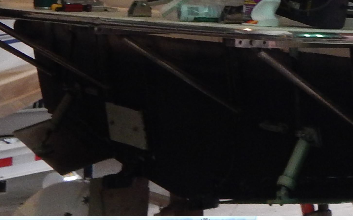

I removed the swim platform mounts on my transom and re-purposed the holes to install underwater lighting. just off-center to port there is a metal plate mounted to the transom below the water line. it is about 16" x 8" or so. It looks like it's been there since the boat was built because there was no bottom paint behind it.
I removed it to have access to install the light, and also prep the area since I am refreshing the bottom paint. I am curious if it is a zinc plate (its non ferrous), but it just "feels" more like aluminum. There is a green wire attached to the studs on the inside, so I am wondering if this is sacrificial metal, or would this be some sort of grounding plate? I am on Lake Michigan, so I really don't need zinc, so I want to know if this can be eliminated.

Could be a ground plate used back in the Pre Vhf days ( am 2 way raido ) also aluminum is used instead of zinc in fresh/brakish water some times ( don't mix )
Update ; The aluminum is used is salt as a replacement for zinc and recommend for brackish water . It is also list for fresh but I believe magnesium would work much better .

Back in the day, I used to have a LORAN that needed to be grounded in this manor.prowlersfish wrote:Could be a ground plate used back in the Pre Vhf days ( am 2 way raido ) also aluminum is used instead of zinc in fresh/brakish water some times ( don't mix )

If it looks like this Bill, it's a grounding plate like Paul stated.

Yes, it looks like that!
And it also had a loran on there at one time. Is there anything other than that radio that grounds to it? I notice that my rudders are also wired up. I may put a 10 meter radio in the boat, so it would come in handy.

Sounds like a Dyna Plate, your electrical ground.

Your showing your age . I believe Loran A used a ground plate ( opps showing my age now )

Also known as a Diver's Zinc. I too had a Loran when I purchased the boat.

I did not scroll down the pic , but now that I did I agree that's a zinc

The right material for sacrificial anodes depends on the type of water you operate in.
"Borrowed" this from West Marine:
One final point is that you might need sacrificial anodes for reasons other than you are thinking about... If a nearby boat at your marina has an electrical issue, that can lead to a flow of current from their boat to whatever ground it can find (which may be your boat). Your anodes may be eroded by a bad ground on boats near you, or electrical cables in the water near you. Better to have an anode erode than the galvanic corrosion eating away at your rudders or props!
Don't just assume that you don't need protection because you are on Lake Michigan... All boats need protection. If you or anyone near you uses electric power, you need protection.
- Zinc or aluminum for salt water: If you are a saltwater boater, you should install zinc or aluminum anodes to prevent galvanic corrosion on the engine and underwater parts of your boat.
- Magnesium for fresh water ONLY: Since fresh water is much less conductive than salt water, magnesium anodes are the best choice because they’re more active (less noble) than zinc or aluminum so they will protect your engine parts more effectively. Caution: do not use magnesium anodes in any application other than fresh water because they will corrode rapidly, exposing your boat and engine to possible damage.
- Aluminum for brackish water: More active than zinc, aluminum anodes are a good compromise where fresh and salt water mix, such as the brackish water of river deltas, or if you use your boat in a variety of water types. Zinc is too passive for brackish water, where it gets covered in a zinc oxide film and becomes inactive. Magnesium corrodes too rapidly (due to the water’s salt content), leaving your boat without adequate protection.
Re: Large metal plate on transom
Not all transom plates are used for grounding, some are there as anodes only.

Big D wrote:Not all transom plates are used for grounding, some are there as anodes only.
The other thing that should be noted is that zinc is not good for the environment hence the movement to do away with them period.
There has been some call for aluminum "zincs "in salt water in some states . I have a set for my boats running gear . But I have not switched as I have none for the Engines or gen and you not suppose to mix them . And wonder about using them when every one else is using real zinc .
Big D . My Northern lights uses a 1 zinc and its in the coolant , they say its no longer needed . Your thoughts ? the HX core is not touching any metal do to the end boots.

Under the right conditions, I don't worry too much about that type of zinc use, can't hurt using it unless you don't check/maintain it if you do use one. If they're saying you don't need them then they've taken dissimilar metal consequences into consideration. As we know, there are alot of heat exchangers with anodes in them on the raw water side and that's great but if you don't check/maintain them they can cause problems when they break apart inside. Another benefit to using magnesium in that type of application (if you can find it) is that if it does break apart before you get to it, the pieces will disolve much much faster than zinc (fresh water).prowlersfish wrote:Big D wrote:Not all transom plates are used for grounding, some are there as anodes only.
