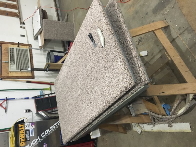

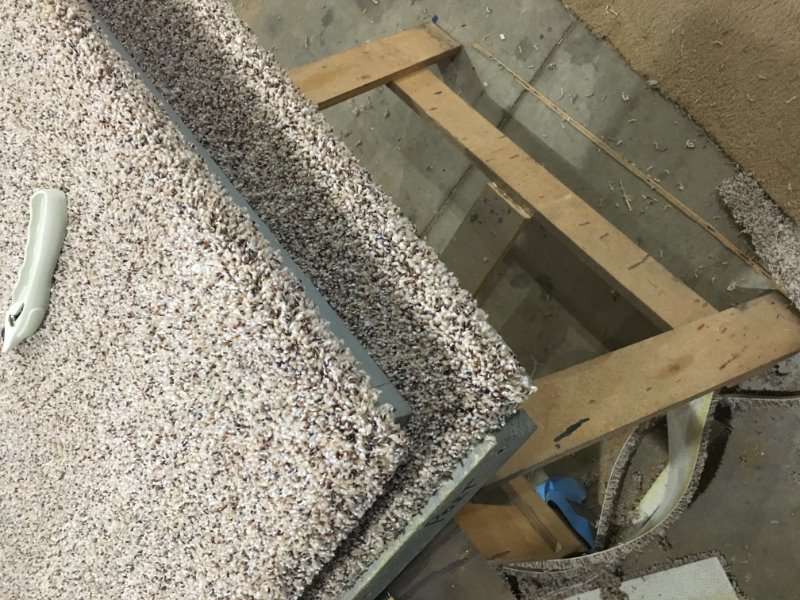

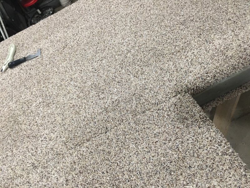

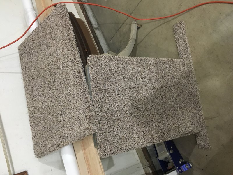

Ok finally got around to installing new carpet in my F-32. I finished the hatches for the salon and will lay the rest of the carpet in the next couple of days. The pictures are of the four salon hatch covers. I use 43 ounce carpet and wrapped all four edges of the hatches and will also wrap the hatch openings. I contact cemented the edges and it worked out great. Permanent but yet can be pulled loose with some effort if I need to change the carpet down the road. The joints between the hatches should literally disappear. I allowed 1/4" for every joint so it should be a tight fit but that's what I want. I will add 1/2" to the large hatch ledgers just to make sure there is enough ledge to catch the two center hatch pieces. I'll update the finished pictures when I get it done hopefully before the fireworks go off on the 4th of July.

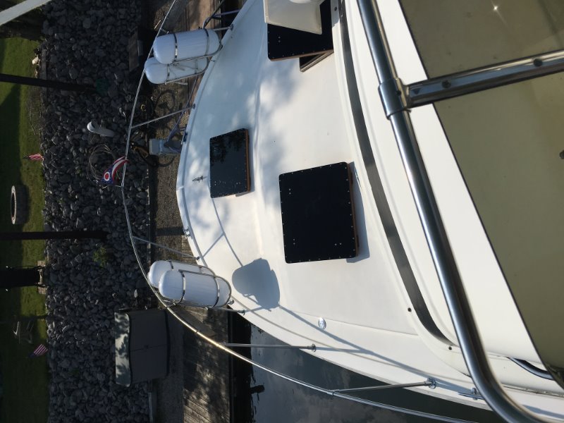

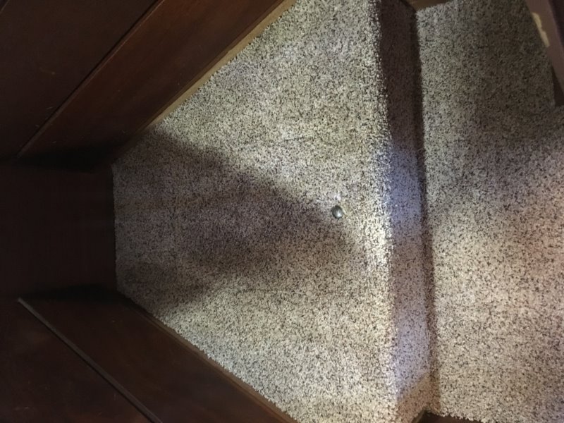

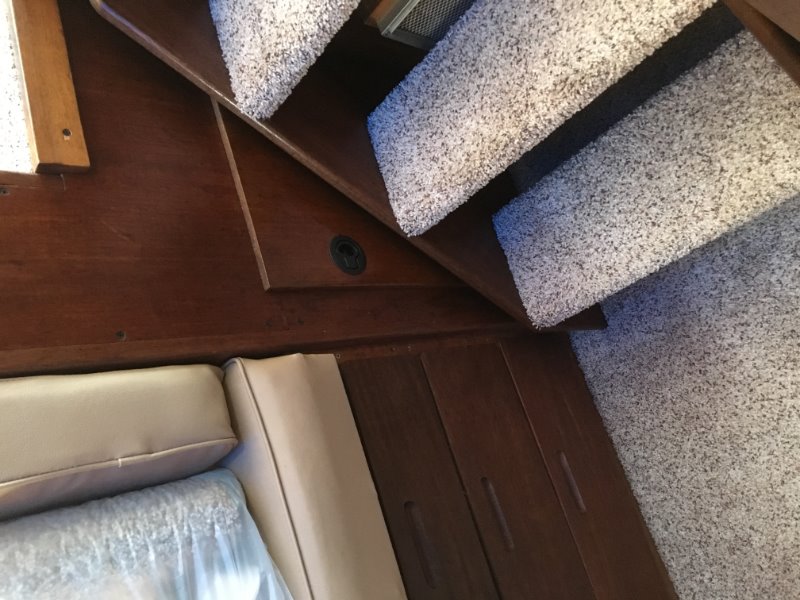

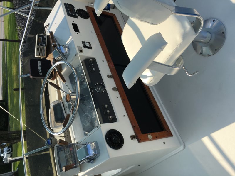

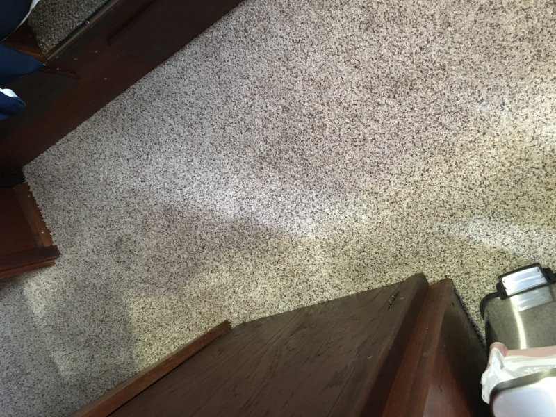

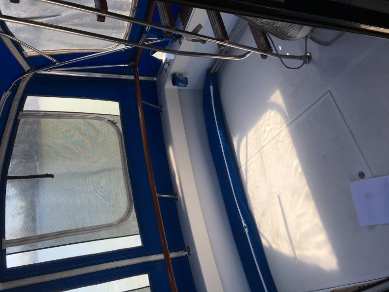

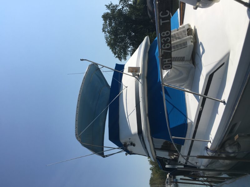

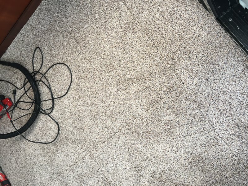

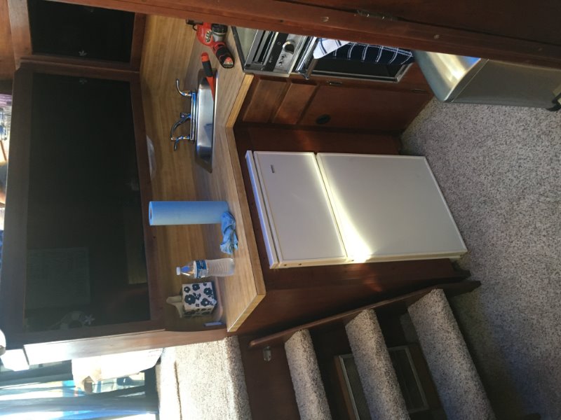

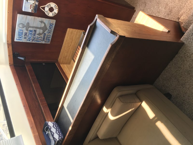

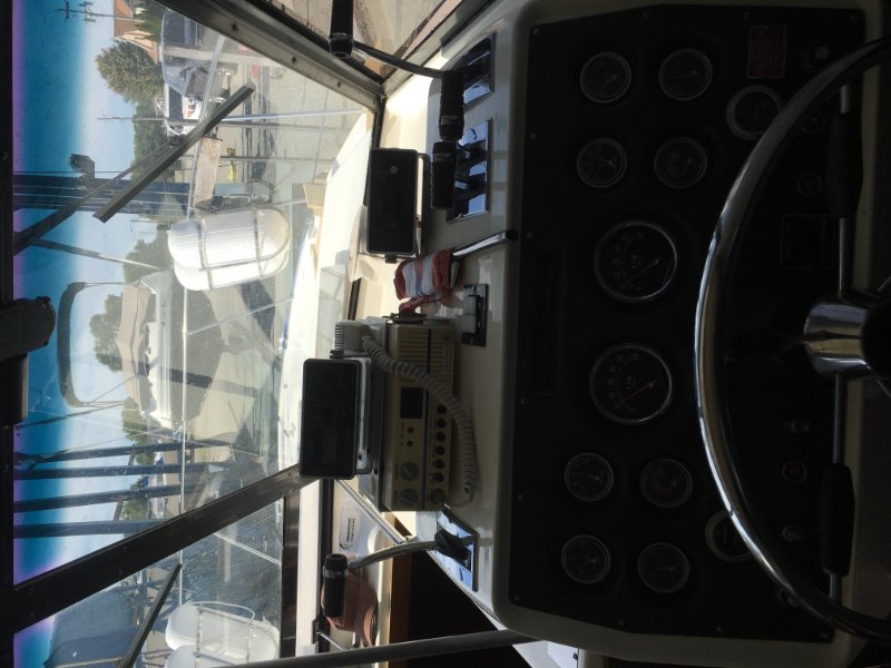

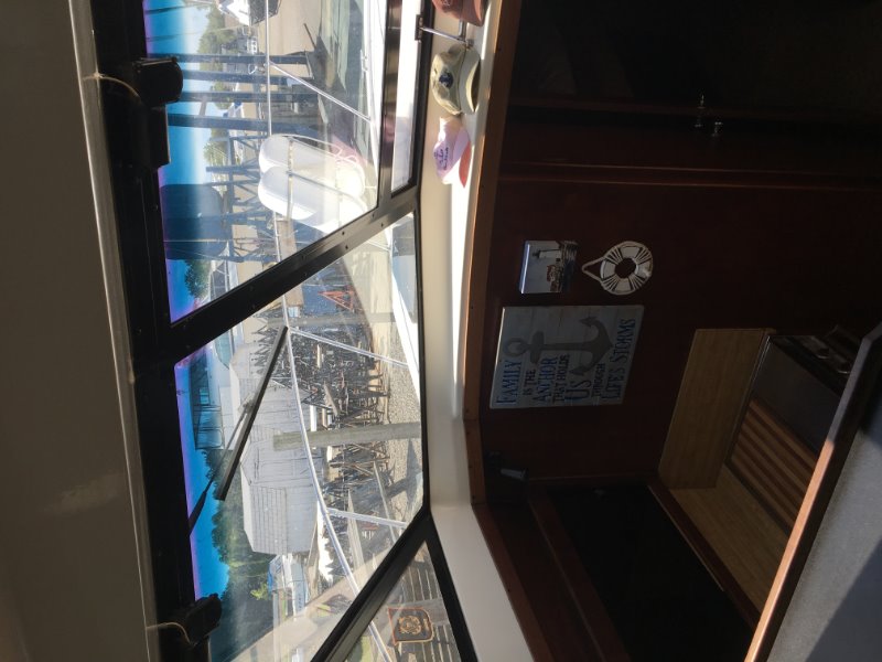

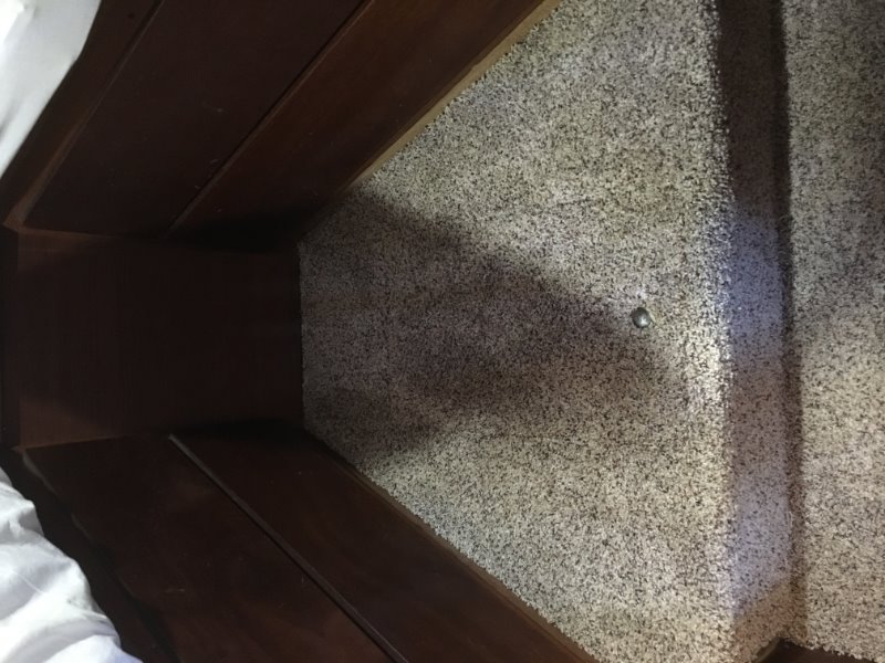

As promised here are pictures of the new carpet in the salon. I also carpeted the galley and V-berth but that's simple installation and I forgot to take pictures. Brought the steps home to redo them so I'll update the galley and V0berth pictures next weekend. I also thru in a picture of the fly bridge after a good cleaning. Finally borrowed a trailer and hauled the bimini top up to the boat too. Wow I like having shade up there lol. My apologies I can't get the (1) picture to be right side up...

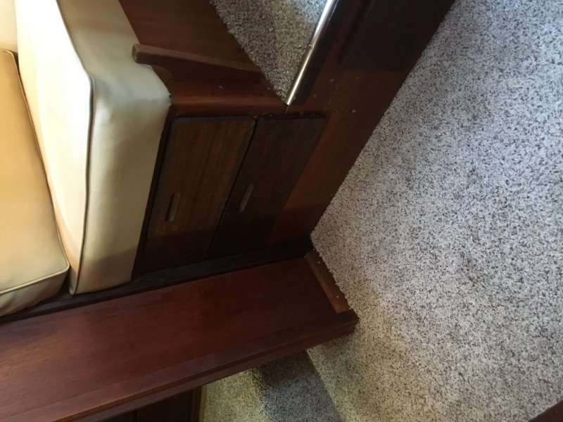

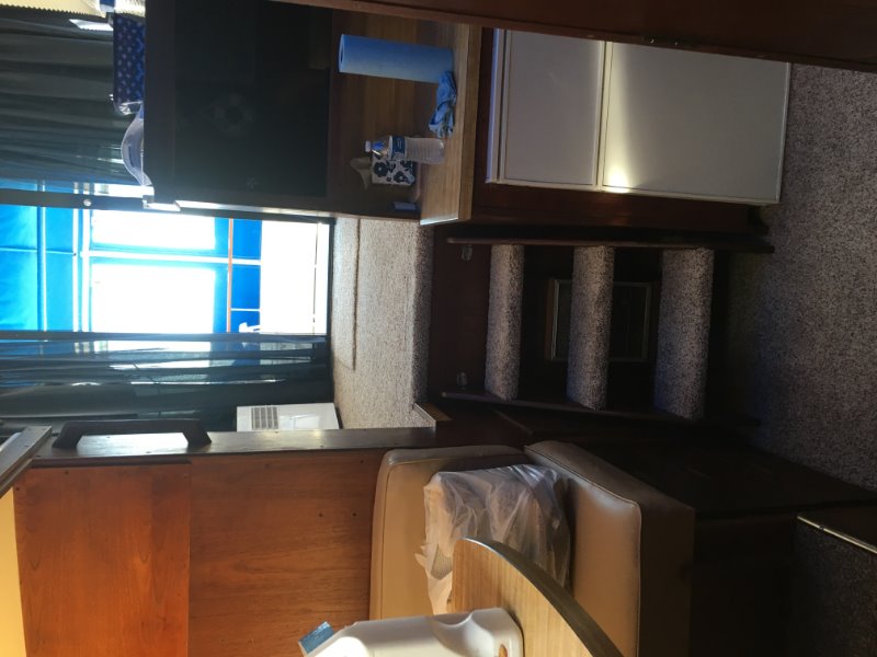

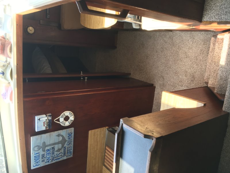

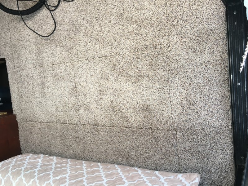

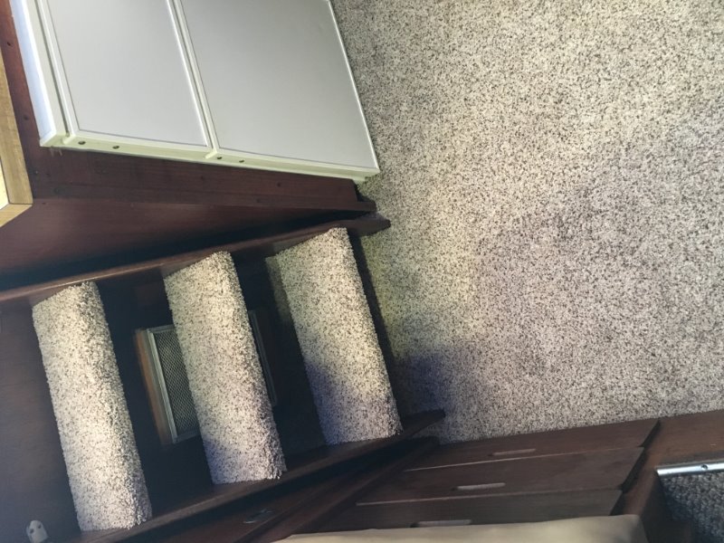

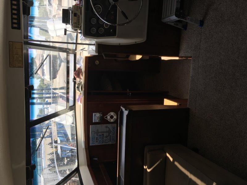

Here are the pictures of the rest of the carpet I redid last week.

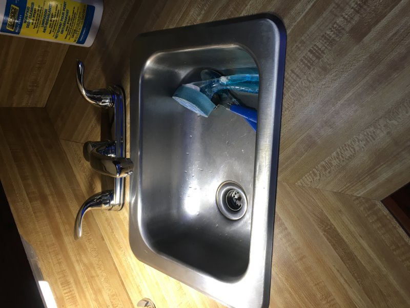

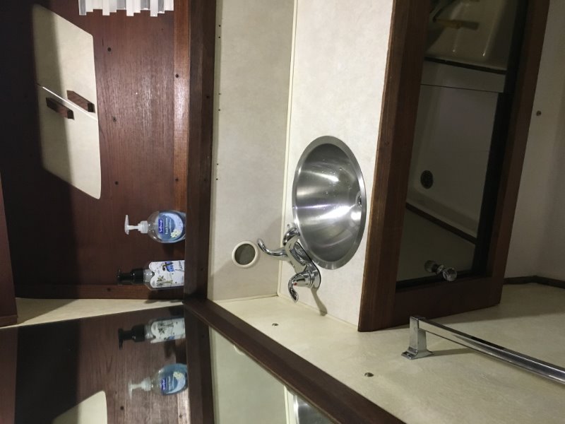

A few updates to share. I installed new kitchen and bathroom faucets. The kitchen was a bit of a challenge as I hade to take out the kitchen sink bowl so I could access the plumbing for the faucet. Bathroom was a simple swap. I changed the two water separator filters and the two inline fuel filters. I also rebuilt one of my Sherwood water pumps. It was leaking again so I thought it was time. I'm glad I did because the shaft was actually wore at the bearing location. Bearings seemed ok but I put everything new in to be safe.

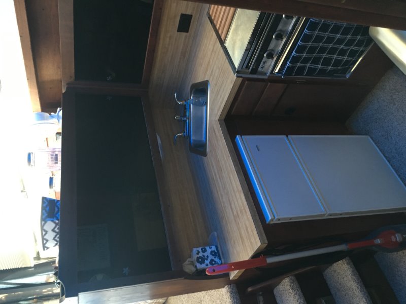

Gally looks great. I'm hoping to be back in the water by next week. Having her cleaned and waxed while on the hard. Then once it's in long island at the new house I'll do the inject a deck on the fly bridge and bow.

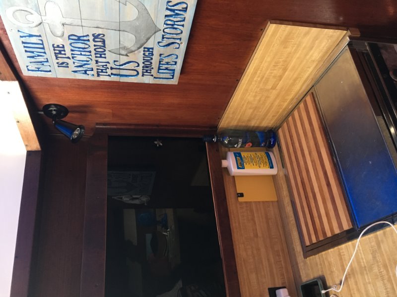

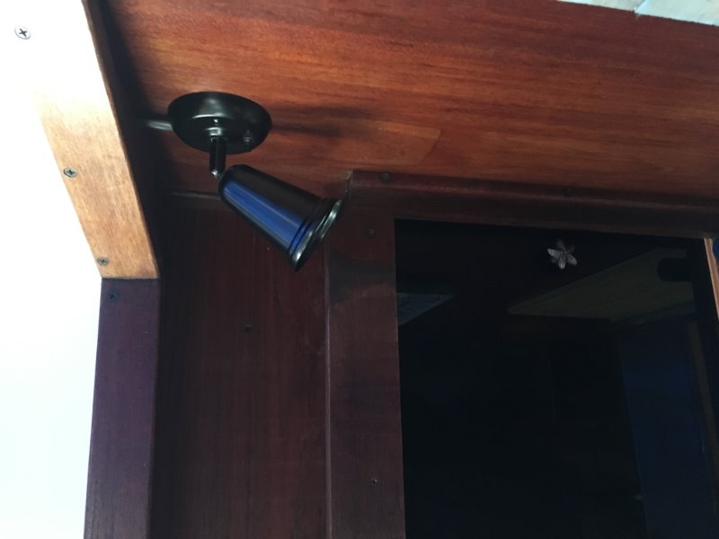

Forgot to show everyone the new light fixture over the galley stove. Mine was missing so I found this one on Amazon. Worked out pretty good I think.

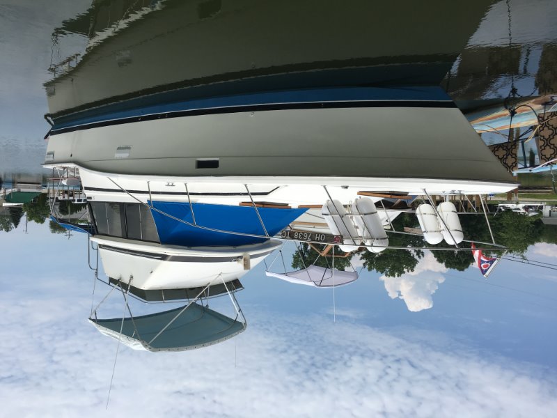

BradZ
Posts: 161
Re: Refitting a 1976 F-32 Journal
Post by BradZ »

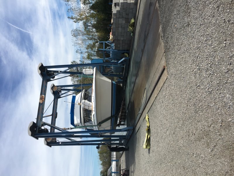

Pulled the boat out here are some pictures. Always a sad day.
