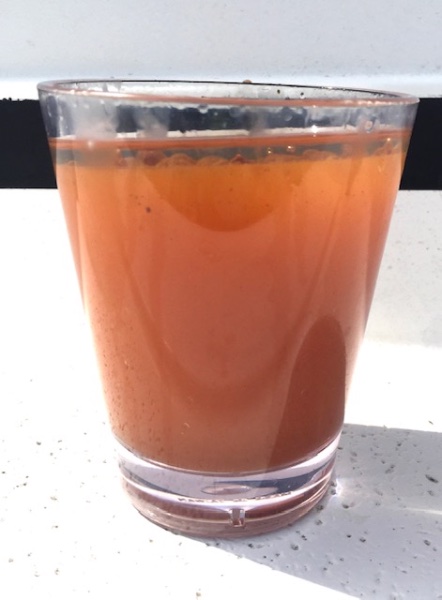

Simple question: Did you check the contents of the old gas filters when you changed them? Hope they didn’t look like this
‘77 F26 HT Since 1999
