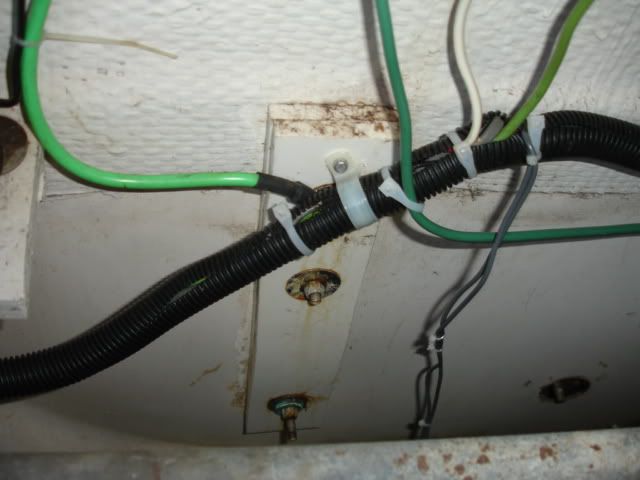

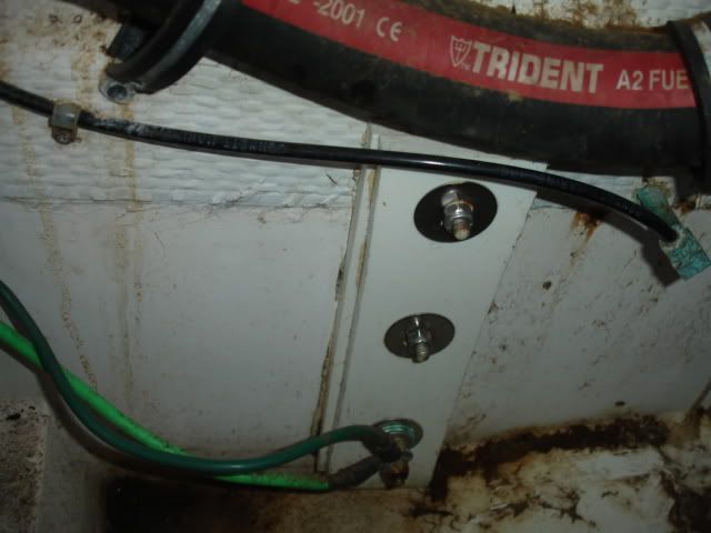

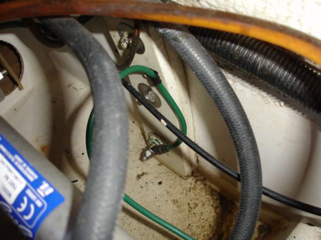

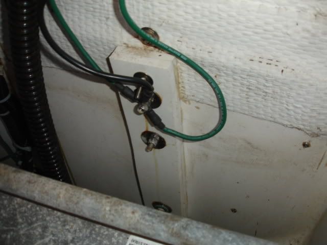

Here's the photos from the inside of the transom on my 1983 10 meter International.
The bonding system ties each one of the stainless swim platform brackets into it .
All of the wooden backing plates have been replaced with starboard.
==================================fourreins wrote:Thank You so much for the photos! Did you double up the starboard pieces? What guage is the wire for the bonding? Is the end of the wire just a circle that slips over the bolt?
1) I doubled up the starboard for strength, Probably should have vsed a thicker starboard, but this eliminated the flex that was there.
2) The wire is probably 8 guage. Every connection I have done on this boat is to ABYC standards and includes a terminal and heat shrink sealant.
3) the end of the wire is a "ring terminal"
Glad to be able to provide the info. Many people helped me when I first got this boat and I'm happy to p[ass along any info I can.
