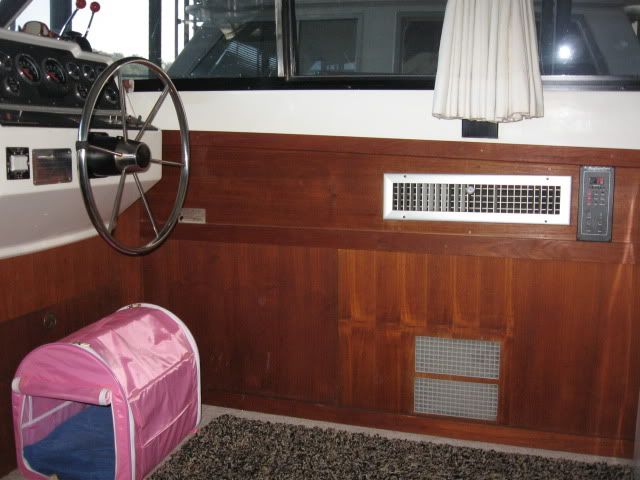

is it a cruisair unit. if so here a digital themostat i have installed on my f32 . this will give you 5-6 speeds for the fan from very low to high either manually set or automatically controlled by the control unit. i have been very very happy with this control and it was simple to install.

i replaced my rotary 3 knob contols with this micro air fx-1 retro fit kit
distributor was AER, piece of cake to install.
heres a link to microair
http://www.microair.net/
click products and go to fx-1 retrofit you can see pic of display and also download the manual.

i have the vertical panel which the part number is listed in the other post i made. it fit in the exact spot the 3 knob rotary control did.
here is a pic of it installed

i have a cruisair split system the evaporator/blower assembly is indeed in the stbd side wall. the picture (in my previous post)shows the air return grille the unit is right behind it. the condensor/compressor is mounted between the aft fuel tanks above the fresh water tank under the cockpit floor. there is also a evaporator and blower assy in the v berth tee'd from the freon lines. i have never regretted installing this digital thermostat. set the temp and forget it.
