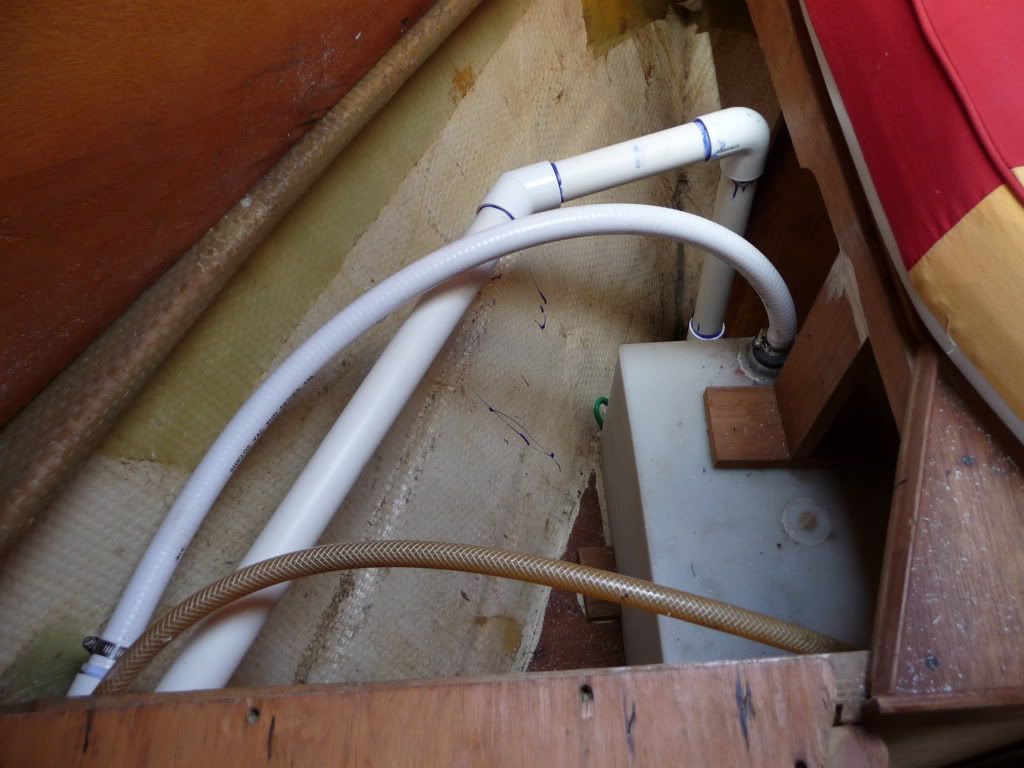

I just got done putting in a whole head system in my tricabin. I put 2 vacuflush systems in and believe me, it wasn't cheap!!!!

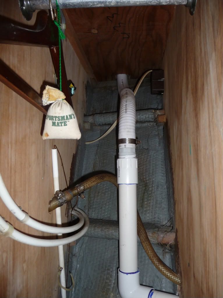

I had the same problem with the oderless hose that it was so dang expensive. Most of the straight-aways in the bilge I did PVC.
Its important to know when doing the PVC is to use sweeping 90's instead of regular 90's. PVC Is cheaper and its heavy duty.
Joe
Joe
- alexander38
- Posts: 3179
Yes the price of that hose is a killer but its worth the price . PVC pipe works well if you can use it. Support it well and you'll be ok but I wouldn't use all pvc use hose at the points that hook up to the boat to cut down on vibrations.

Thanks for all the replies guys, thought about the PVC but it would take alot of angles to get it to where I need to go without taking a ton of cabinetry and the head out. I found a 15' peice at my local marine store of hose for $5 a foot, a little more manageable.

I know what you about try to get the PVC in. I replaced over 50' of hose last yr and not more than 2' straight run any where.
