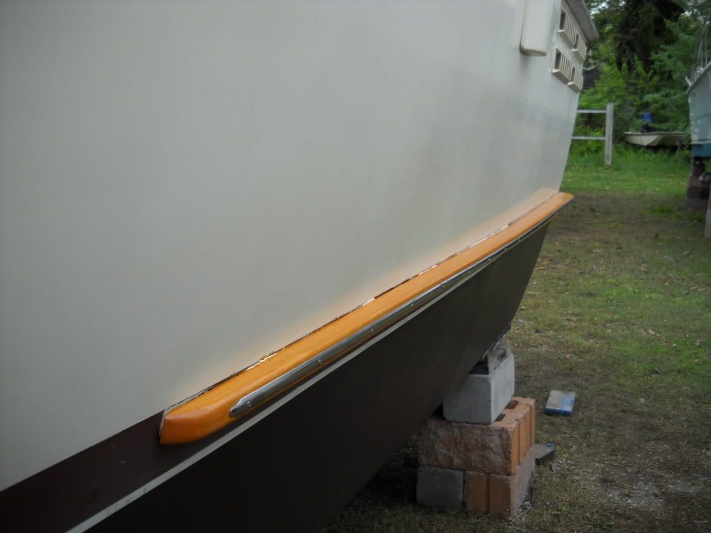

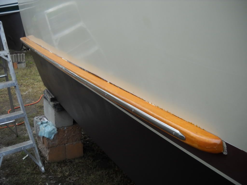

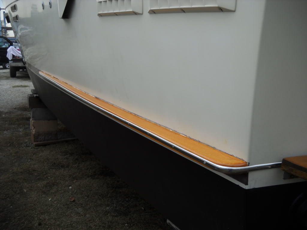

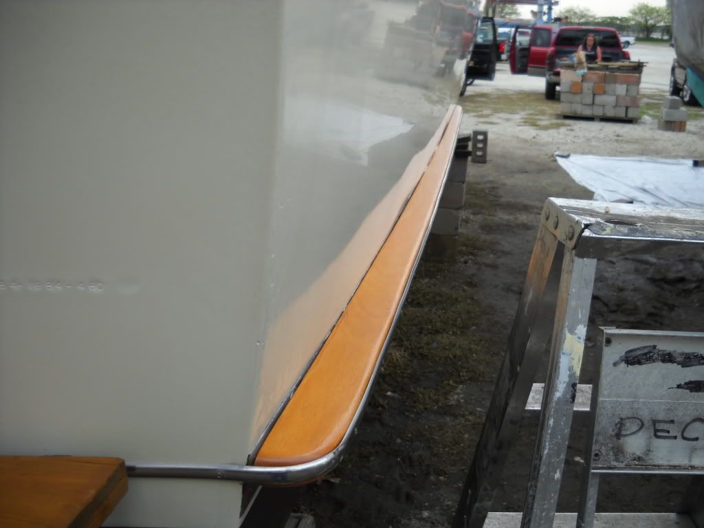

I used African Mahogany to make the new spray rails on my F36. Where are you located? I still have a peice left that might make both of yours.

man that real nice. where did you find the stainless trim for those? i need that as well. and where do you find mahogany?
The stainless was already on the boat and I searched the local lumber companies to see who dealt with exotic woods to find the mahogany.
