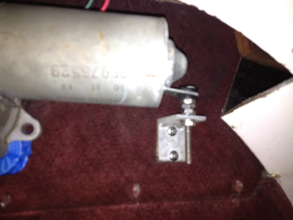

I just measured my bottom and top roller tracks in the head and they are not paralell. Also, as mounted now the rubber friction wheel is really pressing down on the door. How tight of a grip (how much pressure) is required for the friction wheel to work? I guess it should be minimal so the motor isn't overworked. It is so tight now that you can't manually open the door and the motor works and gets hot when opening and closing. Its very slow too!
It doesn't look like my tracks were remounted by the PO, but not sure.

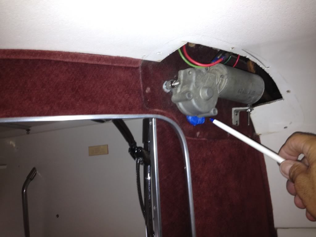

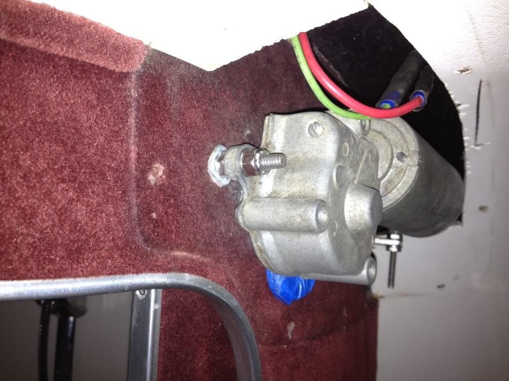

Re: 10M Electric cabin door questions
here are some photos and videos previously posted.
The pen points to where you can add one or more washers taped together as an adjustable shim pack.
