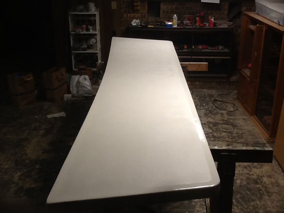

Well, went with Interlux off white Brightside. Did a 1-1/2" area smooth around the non-skid, and have the rub rail already heated and bent to form. Just need to add the Stainless steel inserts and she is ready to be put in the brackets. Did a base coat of precoat primer
Platform is 130" long, 31" wide. Almost big enough to hold a small dance recital.....
Ill post the whole build procedure on a separate post in case anyone else wants to give it a shot. Total cost to build, about $750. Was quoted $4,750..... That savings paid for our new 10' dingy....
sanded smooth, then second coat of precoat, sanded smooth, then one base coat of paint, light sanded, taped off the smooth area, painted non skid area, while working it, I sprinkled on the non skid with a cheese shaker. Then before that coat dried (1/2 hr) I peeled off the tape. Let dry 24 hrs between coats, and finished with two top coats, light sanding only on smooth area. All rolled with foam roller and tipped.Platform is 130" long, 31" wide. Almost big enough to hold a small dance recital.....

Looks Nice
Re: Paint color
Hey, that looks great!
