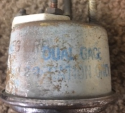

2. There are two types of AC-Delco gauges - a single station gauge and a dual station gauge. AC-Delco gauges are also stamped as 'Single' or 'Dual' on the side (see photo)

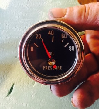

4. Trojan used either white needle or orange needle AC-Delco gauges

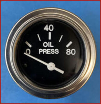

NOTE: Senders for fuel, engine temperature or oil pressure are no longer available. WE *DO* have oil pressure, water temperature and fuel gauges that's a close match with the look of the Delco gauge. We also have senders for the oil pressure, water temperature and fuel.

oil pressure gauge replacement
Above is the appearance of the replacement gauge.
Delco gauges #2
Delco gauges #3
Delco gauges #4
