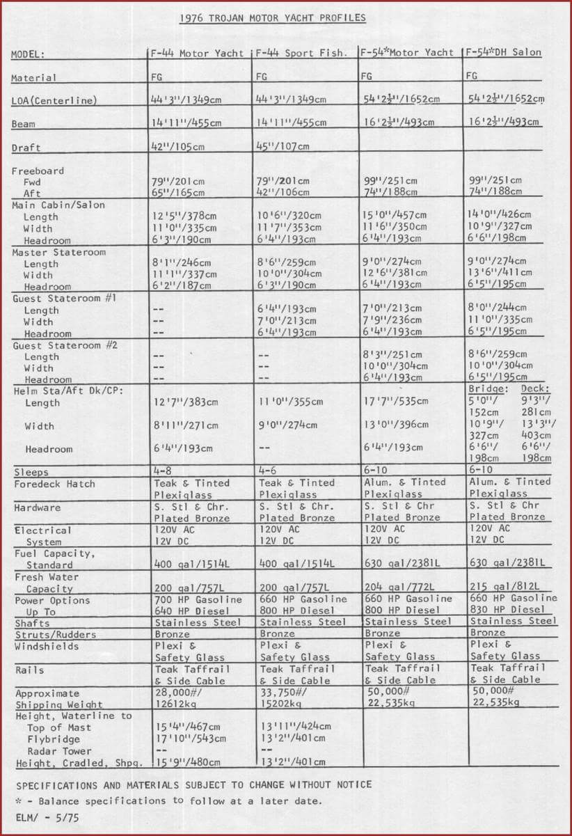

1976 Trojan Motor Yacht Profiles
1976 trojan motor yacht specs

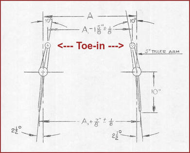

The F-36 over planning problem ...
In the early days of F-36 production, Trojan had a problem with over-planning. Under certain circumstances, the bow would rise and she would lean significantly to starboard when planning. This was unnerving to many new F-36 captains when they were piloting from the Fly-bridge.
This happened more often with the 255 MerCruiser than with the Chrysler 280 and 330. Trojan remedied this issue by requiring the F-36 to be sold with a Generator or two reserve fuel tanks (or both) to act as counterweights. Also, Trojan did not toe in the rudders and they were set to dead ahead. This made the F-36’s the only Trojan’s that DID NOT HAVE toe-in rudders.
F-36 rudders toe-in
Note: It is important to keep the aft fuel tanks and/or the generator if you have an F-36. If you’re not using your aft fuel tanks – they can be disconnected from the fuel system and emptied of fuel and the refilled with water.
